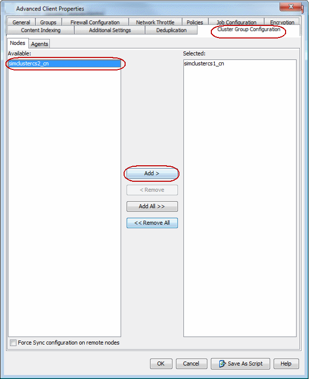

Add a New Client
  1. Install the software on the new physical computer.
    For example, to install the Windows File System iDataAgent, follow the steps described in Getting Started - Windows File System Deployment.
  2. From the CommCell Browser, navigate to Client Computers | <Cluster Group Client>.
  3. Right-click the <Cluster Group Client>and select Properties.
  4. On the Client Computer Properties dialog box, click Advanced.
  5. On the Advanced Client Properties dialog box, click the Cluster Group Configuration tab.
  6. Select the client computer from the Available list and click Add > to move the client to the Selected list.
    Note: New Agents will be available for selection from the Agents tab.
  7. Click OK.
  8. Click OK on the Information dialog box.
    add_client
The client is successfully updated with the cluster group configuration.

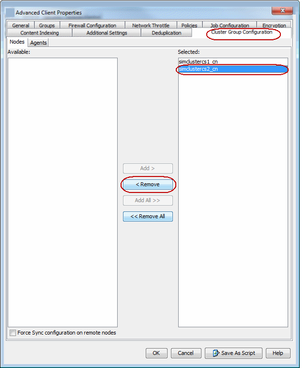

Remove a Client (Deconfigure a Client)
  1. From the CommCell Browser, navigate to Client Computers | <Cluster Group Client>.
  2. Right-click the <Cluster Group Client>and select Properties.
  3. On the Client Computer Properties dialog box, click Advanced.
  4. On the Advanced Client Properties dialog box, click the Cluster Group Configuration tab.
  5. Select the client computer from the Selected list and click < Remove.
  7. Click OK on the Information dialog box.
    The client is successfully deconfigured from the cluster group.
  8. Optional: To delete the deconfigured client, right-click the client and then click All Tasks > Delete.
  9. In the Confirmation box, click Yes to delete the deconfigured client computer.

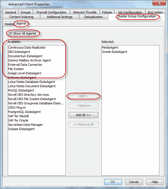

Add an Agent
Use the following steps to add an agent that is already installed on the physical computer:
  5. Click the Agents tab.
  6. Select an Agent from the Available list and click Add > to move the Agent to the Selected list.
  7. Click OK.
    add_agent

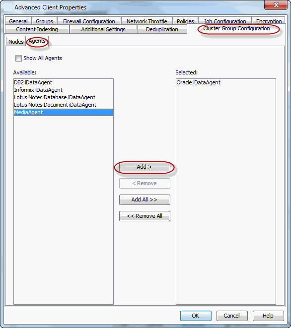

Add an Agent that is not Installed on a Physical Node
To add an Agent to the cluster group client, you need to install the Agent on a physical computer associated with the cluster client. Use the steps below to accomplish this operation.
  1. Install the Agent software on the physical computers.
  6. Click the Agents tab.
  7. Select the Agent you installed in Step 1 from the Available list and click Add > to move it to the Selected list.
  8. Click OK.
  9. Click OK on the Information dialog box.
    add_agent_not_installed
The new Agent in the cluster group is ready for backup and restore operations.

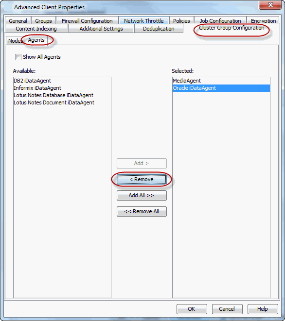

Remove an Agent
  5. Click the Cluster Group Configuration tab and then click the Agents tab.
  6. Select an Agent from the Selected list and click < Remove.
  7. Click OK.
remove_agent
