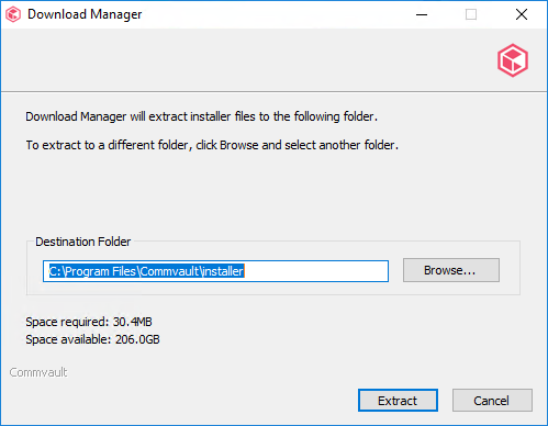

  2. Launch the Commvault software installation package.
    The Download Manager dialog box appears.
    embd_Installing the Standby CommServe Host procedure (9)
  3. Click Extract.

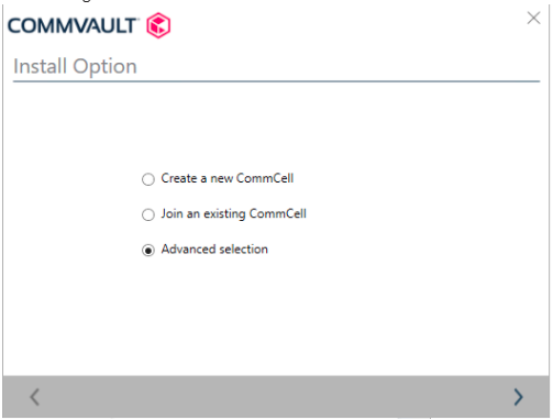

    The Install Option page appears.
    embd_Installing the Standby CommServe Host procedure (30)

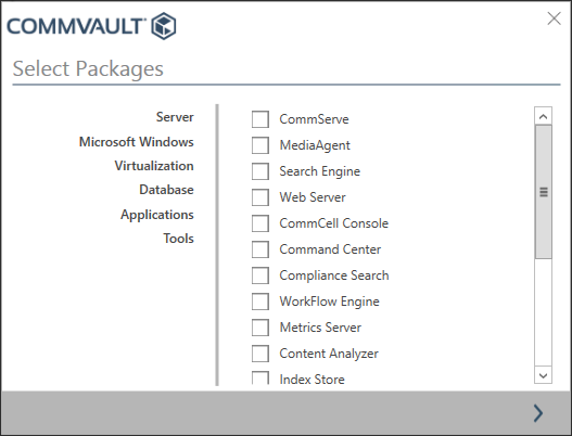

  7. Select Advanced selection, and then click the arrow to proceed.
    The Select Packages page is displayed.
    embd_Installing the Production CommServe Host procedure (29)
  8. Select the following check boxes, and then click the arrow to proceed.
    • CommServe check box
    • CommServe Failover check box (Scroll through the list to locate this package.)
      The CommServe Failover package automatically installs the SQL Server agent and the CommServe Failover packages in a new instance. (No additional user intervention is needed.)

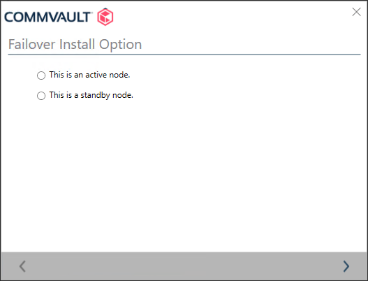

  10. The Failover Install Option page appears.
    embd_Installing the Standby CommServe Host procedure (14)
  11. Select This is a standby node, and then click the arrow to proceed.

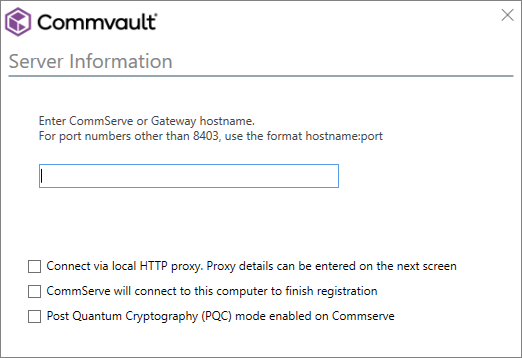

  15. Select / enter the following information:
    • Type the Fully Qualified Domain Name (FQDN) of the production CommServe host.
    • Select the CommServe will connect to this computer to finish registration later option if the CommServe computer must initiate communications with the client.
    • Select Post Quantum Cryptography (PQC) mode enabled on Commserve if PQC is enabled on the CommServe server. PQC encrypts and decrypts data to protect it from attacks by quantum computers.
    Click the arrow to proceed.

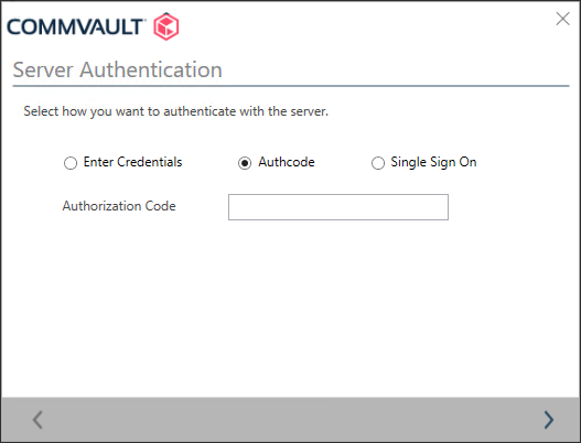

    The Server Authentication page appears.
    embd_Installing the Standby CommServe Host procedure (20)
  16. Select an authentication method for accessing the production CommServe host, and then click the arrow to proceed.
    This completes the SQL Client installation and the following prompts are displayed for installing the standby CommServe client.

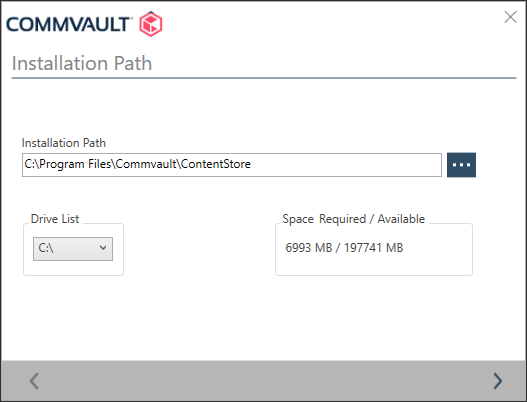

  18. Verify the path (or specify a new the path) for the standby CommServe server, and then click the arrow to proceed.
    Important
    Note that this Installation Path is for the CommServe server.

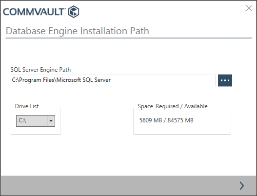

    The Database Engine Installation Path page is displayed.
    embd_Installing the Production CommServe Host procedure (34)
  20. Verify the database engine installation path (or specify a new path) and then click the arrow to proceed. (This is the path for installing Microsoft SQL Server.)

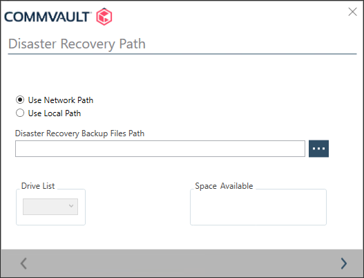

    The Disaster Recovery Path page appears.
    embd_Installing the Standby CommServe Host procedure (25)
  22. Select Use Network Path or Use Local Path, enter the path in Disaster Recovery Backup Files Path, and then click the arrow to proceed.

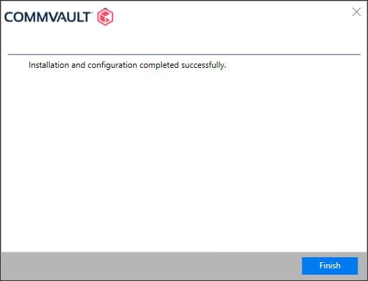

    The software creates the databases and services. This process may take a few minutes.
    A message similar to the following appears:
    embd_Installing the Standby CommServe Host procedure (27)
  24. Click Finish to complete the installation.
  • To troubleshoot errors that occur before the installation summary page, check the %allusersprofile%\Commvault Systems\Galaxy\LogFiles\Install.log file.
  • If the error occurs after the summary page, check the installation logs in the software_installation_directory\Log Files folder.
