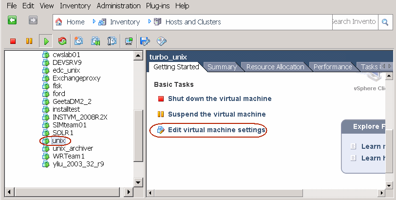

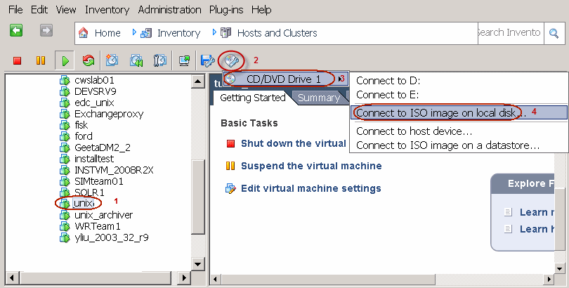

  1. Log on to ESX Server.
    Download the ISO Image on ESX Server.
    Start the ESX Server Client.
  2. Click CD/DVD Drive 1 | Connect to ISO Image on Local Disk.

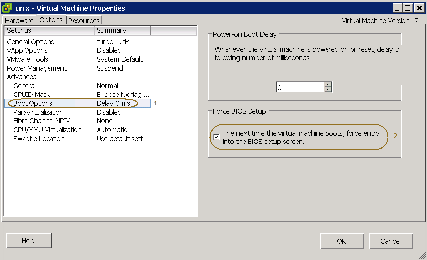

  3. Click Edit virtual machine settings.
  4. Click Options.
    Click Boot Options.
    Click The next time virtual machine boots, force entry into BIOS setup screen.
  5. Power Off the virtual machine.

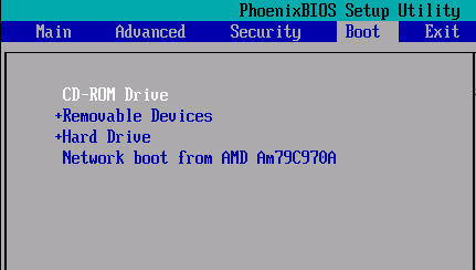

    Power On the virtual machine.
    Select CD-ROM Drive from the Boot menu.
