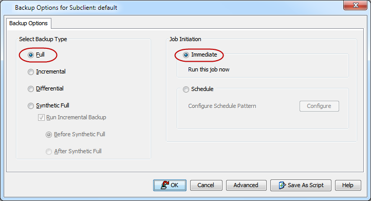

Full Backups
  1. Full backups provide the most comprehensive protection of data. From the CommCell Browser, navigate to <Client> | File System | defaultBackupSet.
  2. Right click the <Subclient> and click Backup.
  3. Select Full as backup type and Immediate to run the job immediately.
  4. Click OK.
    You can track the progress of the job from the Job Controller or Event Viewer window. When the backup has completed, the Job Controller displays Completed.

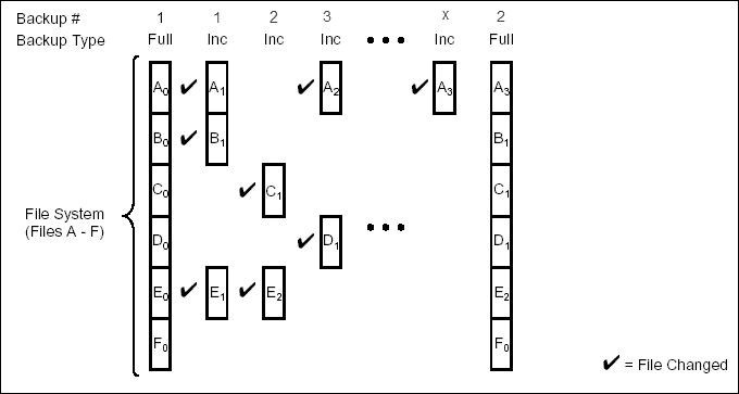

Incremental Backups
An incremental backup contains only data that is new or has changed since the last backup, regardless of the type. On average, incremental backups consume less media and use less resources than full backups.
The illustration below clarifies the nature of full and incremental backups. For simplicity, assume there is a file system that contains six files as represented in the figure.
Backup #1 is a full backup and therefore writes all the data, changed and unchanged, to the backup media. Backups #2 through #n-1 are incrementals and only back up those files that have changed since the time of the last backup, regardless of the type. For example, files A, B, and E changed after the full backup and were therefore backed up in Backup #2. Backup #4 backed up files A and D because both files were modified sometime after Backup #3 occurred. File F did not change; hence, it was not backed up in any of the incremental backups, but it was included in both full backups, which, by definition, back up everything.
incremental

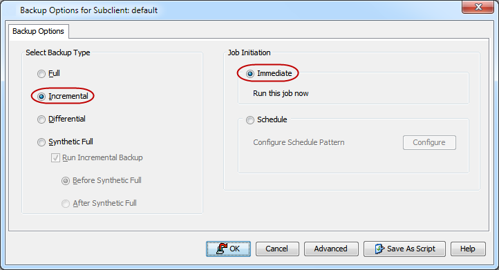

Follow the steps below to perform an incremental backup:
  1. From the CommCell Browser, navigate to <Client> | File System | defaultBackupSet.
  3. Select Incremental as backup type and Immediate to run the job immediately.
  4. Click OK.
    You can track the progress of the job from the Job Controller. When the backup has completed, the Job Controller displays Completed.

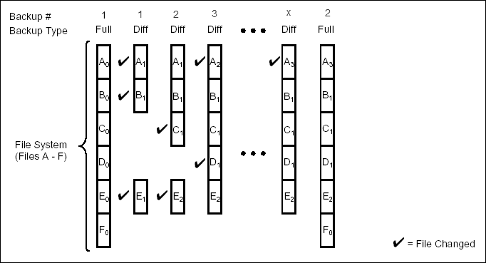

Differential Backups
A differential backup contains only the data that is new or has changed since the last full backup. Like incremental backups, differential backups, on average, consume less media and place less of a burden on resources than full backups. Differential backups are cumulative. This means that each differential backup contains all changes accumulated since the last full backup. Each successive differential backup contains all the changes from the previous differential backup.
The illustration below demonstrates the nature of differential backups. For simplicity, assume there is a file system that contains six files as represented in the figure.
Backup #1 is a full backup and therefore writes all the data to the backup media. Backups #2 through #n-1 are differential backups and only back up those files that changed since the time of the last full backup. For example, files A, B, and E changed after the full backup and were therefore backed up in Backup #2 as well as all subsequent differential backups. File C changed sometime after Backup #2 and was consequently backed up in Backup #3 and all subsequent differential backups. File F did not change; hence, it was not backed up in any of the differential backups, but it was included in both full backups, which, by definition, back up everything.
differential

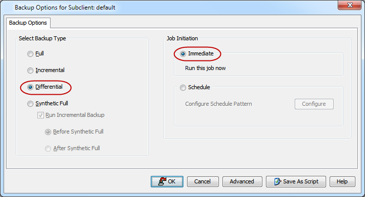

Follow the steps below to perform a differential backup:
  3. Select Differential as a backup type and Immediate to run the job immediately.
  4. Click OK.
    You can track the progress of the backup job from the Job Controller. When the backup has completed, the Job Controller displays Completed.

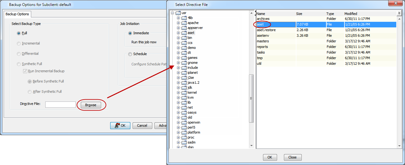

Performing an On-Demand Backup
  1. From the CommCell Browser, navigate to <Client> | File System |<On-Demand Backup Set>.
  3. Click Browse.
  4. Navigate to the Directive file or Content file that you want to use.
  5. Click OK.
  6. Select Immediate to run the job immediately.
  7. Click OK.
bkp_ondemand

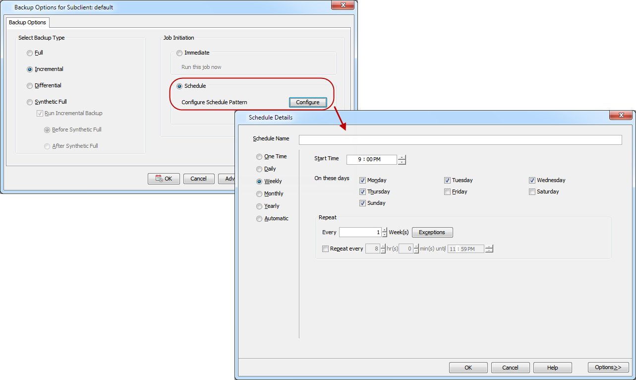

Scheduling Backups
  1. From the CommCell Console, navigate to Client Computers | <Client> | File System | defaultBackupSet.
  2. Right click the default <Subclient> and click Backup.
  3. Click Schedule.
  4. Click Configure.
  5. Select the appropriate scheduling options. For example:
    • Click Weekly.
    • Click OK to close the Backup Options dialog
schedule_details
See Scheduling for comprehensive information on scheduling jobs.
