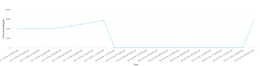

Trend of pending jobs in previous 24 hours Chart
This chart displays the trend of the pending jobs in the previous 24 hours.
Trend_pending_jobs_24_hours

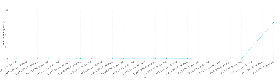

Trend of pending jobs at same hour in last 30 days Chart
This chart displays the trend of the pending jobs at the same hour in the last 30 days.
Trend_pending_jobs_30_days
