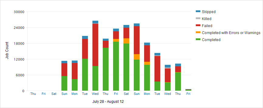

Last 16 Days Backup Statistics
This chart displays the number of jobs on each of the last 16 days that were killed, failed, completed with errors or warnings, or completed successfully. This chart can also display jobs that were scheduled to run but were skipped.
Job Status Table
This table specifies the total number of jobs in each status on each day, including the total number of jobs and the success percentage.
Row |
Description |
Committed |
The number of backup jobs that a user interrupted and committed. For more information about committing jobs, see Committing a Backup Job by Using the Kill Option. |
Completed |
The number of jobs that completed successfully on the indicated day. |
Completed with Errors or Warnings |
The number of jobs that completed with errors or warnings on the indicated day. |
Failed |
The number of jobs that failed to complete on the indicated day. |
Killed |
The number of jobs that a user killed on the indicated day. |
Skipped |
The number of jobs that were scheduled to run but did not run. Appears when you select Show Skipped Jobs. Skipped jobs also include jobs that failed to start because another job was already running for the same subclient. |
Total |
The total number of jobs that ran on the indicated day. |
Success Rate (%) |
The percentage of jobs that completed successfully or were committed on the indicated day. (Completed + Completed with errors + Completed with warnings + Committed) * 100/Total jobs = Success rate. |

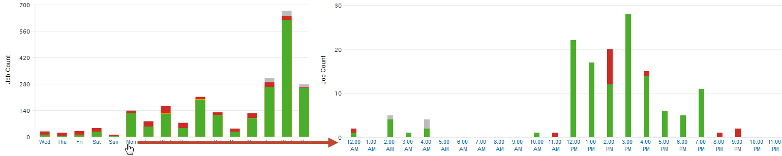

Hourly Backup Jobs
This report displays a table and chart that include information about jobs during each hour of the specified day.
After you first enable the Activity Report in the Control Panel, It can take up to seven days to retrieve the latest data for this report.
View this report by clicking on a day link under one of the bars in the Last 16 Days Backup Statistics Chart:
Hourly Backup Jobs on Date
This chart displays the number of jobs that completed, completed with errors or warnings, failed, or killed, during each hour of the specified day.
Hourly Backup Jobs
This table displays the number of jobs in each status during each hour of the specified date.

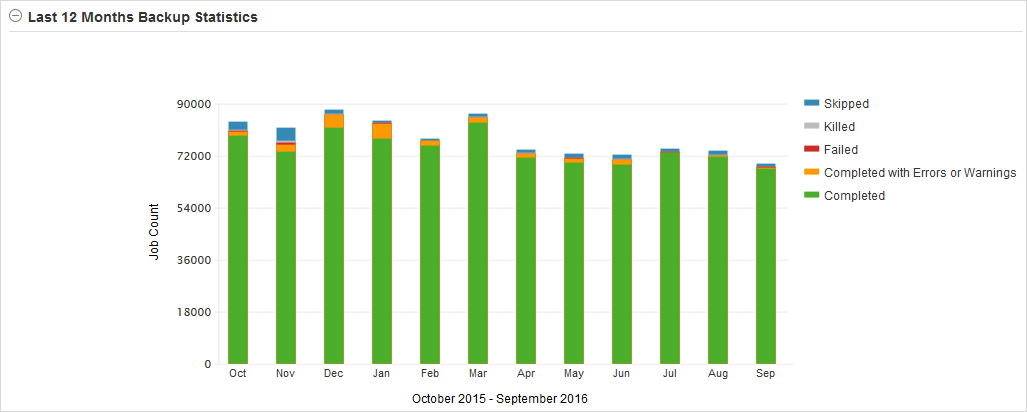

Last 12 Months Backup Statistics
This chart displays the number of jobs on each of the last 12 months that were killed, failed, completed with errors or warnings, or completed successfully. This chart can also display jobs that were scheduled to run but were skipped.
Job Status Table
This table specifies the total number of jobs in each status in each month, including the total number of jobs and the success percentage.
Row |
Description |
Committed |
Completed |
The number of jobs that completed successfully in the indicated month. |
The number of jobs that completed with errors or warnings in the indicated month. |
Failed |
The number of jobs that failed to complete in the indicated month. |
Killed |
The number of jobs that were killed by a user in the indicated month. |
Skipped |
The number of jobs that were scheduled to run but did not run in the indicated month. Appears when you select Show Skipped Jobs. Skipped jobs also include jobs that failed to start because another job was already running for the same subclient. |
Total |
The total number of jobs that ran in the indicated month. |
Success Rate (%) |
The percentage of jobs that completed successfully or were committed in the indicated month. (Completed + Completed with errors + Completed with warnings + Committed) * 100/Total jobs = Success rate. |

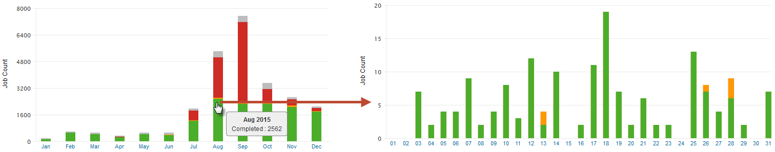

Daily Backup Jobs
You can view this report by clicking on a day or a bar in the Last 12 Months Backup Statistics Chart. You can view this chart only in the Activity Report on the Private Metrics Reporting Server.
This report displays a table and chart that include information about jobs on each day in the specified month.
Daily Backup Jobs on Month
This chart displays the number of jobs that completed, completed with errors or warnings, failed, or killed, on each day in the month.
Daily Backup Jobs
This table displays the number of jobs in each status during each day of the month.
Column |
Description |
Date |
The date selected from the Last 16 Days Backup Statistics. |
Committed |
Completed |
The number of jobs that completed successfully on the date. |
The number of jobs that completed with errors or warnings on the date. |
Failed |
The number of jobs that failed to complete on the date. |
Killed |
The number of jobs that were killed by a user on the date. |
Skipped |
