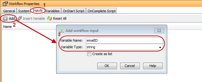

Add a String Type Input
  1. From the Workflow window, go to the Workflow Properties pane.
  2. On the Inputs tab, click Add.
  3. In the Variable Name box, enter the name of the string input, for example, email_ID.
  4. From the Variable Type list, select string.
  5. If you want to define more than one value for this input, keep the Create as list check box selected to store all values in a list.
input_string

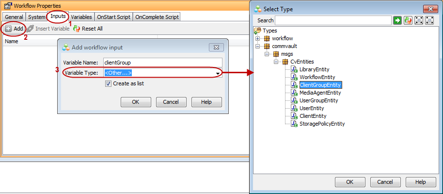

Add an Type Input
The following steps create an input that will recognize client groups in the CommCell:
  3. In the Variable Name box, specify a name for the client group variable.
  4. From the Variable Type list, select <Other ...>.
  5. From the Select Type dialog box, select ClientGroupEntity and click OK.
  6. If you want to define more than one value for this input, keep the Create as list check box selected to store all values in a list.
  7. Click OK.
input_other_type
