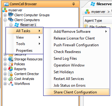

  1. From the CommCell Console, navigate to the Client Computers node and right-click the <Client> you need to share.
  2. Point to All Tasks and then click Share Client Configuration.

    select_share_client

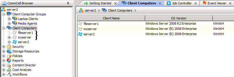

  8. In the Source CommCell, the target (registered) CommCell clients will be displayed as deconfigured clients under Client Computers.
    target_on_source
