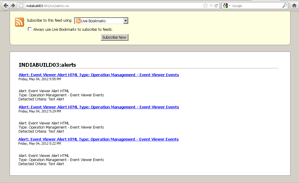

You can send alerts in the form of RSS feeds which can be automatically integrated with your web browser. The following is an example of an RSS Feeds notification alert:
alert_rss
  1. Create an alert.
  2. On the Notification Type(s) Selection page, click the RSS Feeds tab to send the alert to an RSS feed.
  3. Click the Select [RSS Feeds] for notification check box.
  4. If you need to provide a different RSS feed location (other than the default alerts,rss), select the location from the Select/Enter the Feed Location drop-down list.
  5. Click Next.
  6. Review your selections on the Summary page.
  7. Click Finish.
