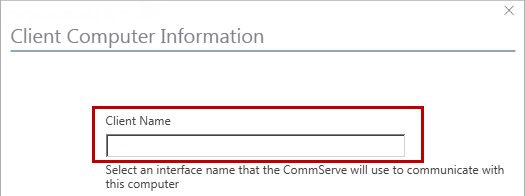

    • Later on the installation, on the Client Computer Information page, make sure that you provide the old CommServe Client Name and set the Hostname of the server's hostname as it is set in the OS.
      cs_client_info_installer
