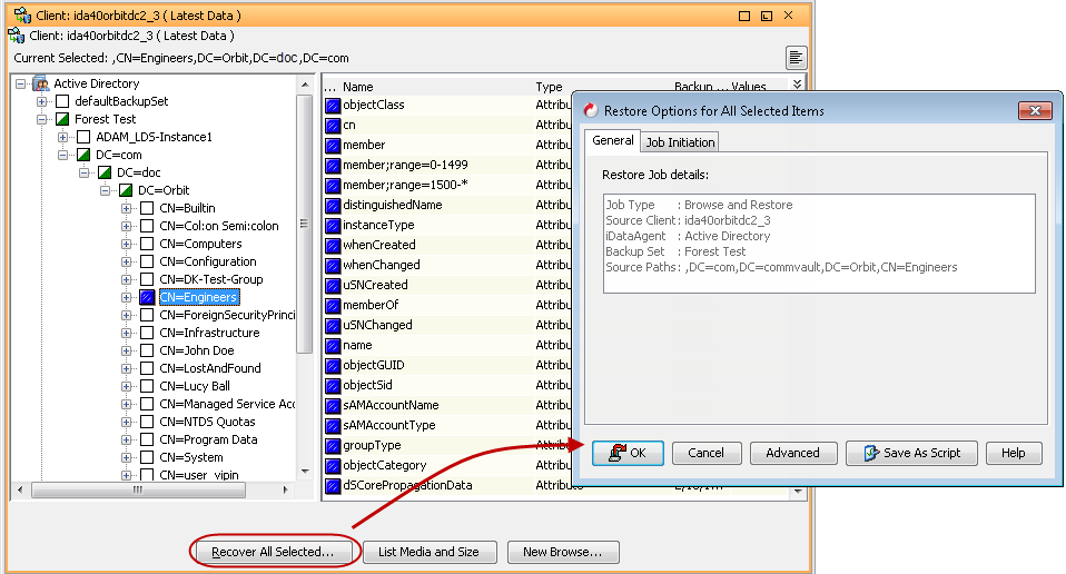

Restoring Objects
Follow the steps given below to restore an active directory object:
  1. From the CommCell Browser, navigate to Client Computers | <Client> | Active Directory.
  2. Right-click a Backup Set and click All Tasks | Restore.
  3. Click OK.
  4. Select the object that you want to restore. All the attributes of the object are selected automatically.
    The object and its attributes will be restored to the same location from where it is backed up. Verify that the parent OU or container exists before you start the restore job. Otherwise, the restore job fails.
  5. Click Recover All Selected.
  6. Click OK
restore_object

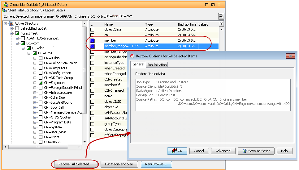

Restoring Attributes
You can restore attributes of an existing object in the active directory tree. You can perform an in-place restore of the attribute.
  3. Click OK.
  4. Navigate to the object for which you want to restore the attribute.
  5. Select the attributes that you want to restore and click Recover All Selected.
    The attributes will be restored to the same location from where they are backed up.
  6. Click Recover All Selected.
  7. Click OK.
restore_attribute
Restoring Attributes of a Deleted Object
You can restore attributes of a deleted object in the active directory tree. You can perform an in-place restore of the attribute.
  3. Click OK.
    The attributes will be restored to the same location from where they are backed up. The object will be recreated while restoring the attributes. Ensure that the Organization Unit (OU) of the object still exists on the source computer.
  7. Click OK.
restore_attribute

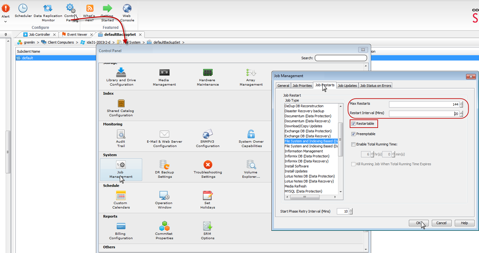

Restarting Jobs
Jobs that fail to complete successfully are automatically restarted based on the job restartability configuration set in the Control Panel. Keep in mind that changes made to this configuration will affect all jobs in the entire CommCell.
To Configure the job restartability for a specific job, you can modify the retry settings for the job. This will override the setting in the Control Panel. It is also possible to override the default CommServe configuration for individual jobs by configuring retry settings when initiating the job. This configuration, however, will apply only to the specific job.
Backup jobs for this Agent are resumed from the point-of-failure.
    • In the Job Type box, select the job that you want set the restart capability for (for example, for DB2 backup jobs, select DB2 Data Protection).
  4. Click OK.
job_restarts
