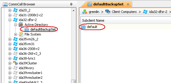

You can make advanced configuration changes at the subclient level or backup set level.
Active Directory iDataAgent uses following main components to perform backup and restore operations from the CommCell Console.
Backup Set - collective information of all the data that needs to be backed up for the client.
Subclient - defines the data to be backed up.
understanding_com_con

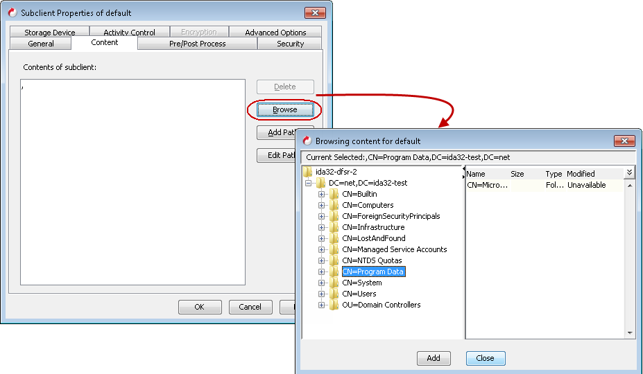

Creating a Subclient to Back Up Specific Organizational Units
The default subclient contains the entire active directory database. You can create user defined subclient to manage and back up specific Domain Components (DC), Organizational Units (OU) or Common Names (CN).
  1. From the CommCell Browser, navigate to Client Computers | <Client> | Active Directory | Backup Set.
  6. Click the Content tab.
  7. Click Browse.
  8. Select the organizational unit to be backed up and click Add.
    Repeat this step to include all the organizational units to be backed up.
    When you add an organizational unit to a subclient, it is automatically excluded from the default subclient.
  9. Click Close.
  10. Click OK.

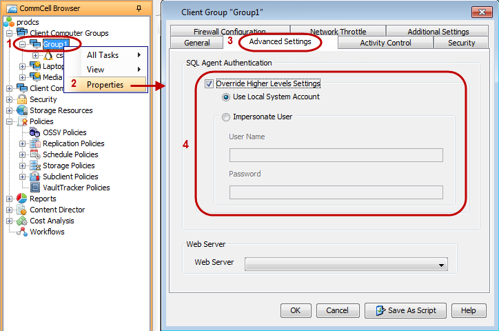

At the Client Computer Group Level
This user account will be used for all computers within a Client Computer Group. Configure the user account at this level if different users will be conducting backup and restore operations for each Client Computer Group in your organization. This user account will override the user account configured at the CommCell level.
  1. From the CommCell Browser, navigate to the Client Computer Groups node.
  2. Verify that all the Agent clients for which you wish to configure the user account are included in the Client Computer Groups.
  3. Right-click the <Client Group> and click Properties.
  4. Click the Advanced Settings tab.
  5. Click the Override higher levels settings check box.
  6. Select one of the following:
    • Use Local System Account, if the computer's Administrator account contains the required privileges.
    • Impersonate User, if you want to use a different account that contains the required privileges. Type the User Name and Password for this account in the space provided.
  7. Click OK.
user_account_02
The user credentials provided at the client computer group level are ignored if the client belongs to more than one group. In this case, provide the user credentials at the instance level.

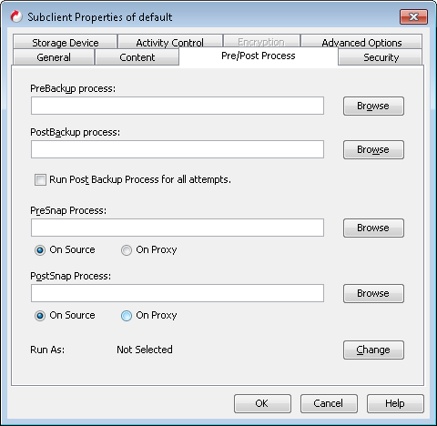

See Pre-process and Post-process - Commands and Arguments for information on additional arguments that the CommServe sends to the Pre-processes and Post-processes.
  1. From the CommCell Browser, navigate to Client Computers | <Client> | Active Directory | BackupSet.
  5. Select the batch file or shell script and then click OK.
pre_post_process_1

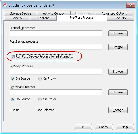

  4. Select the Run Post Backup Process for all attempts check box.
  5. Click OK.
pre_post_process_2

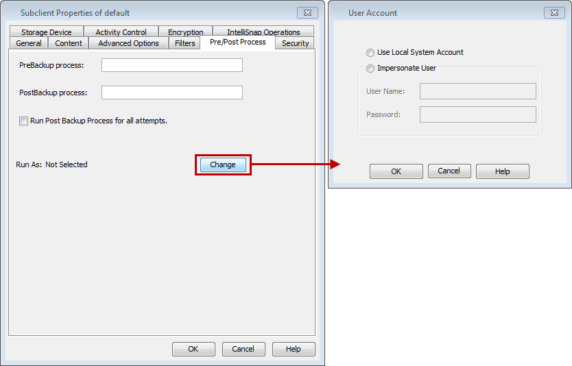

Changing User Account for Executing Pre-process and Post-process Commands
You must specify the user account and password required for executing the pre-process and post-process commands.
  4. Click Change.
  5. Select one of the following user accounts:
    • Use Local System Account - Select this option to use the local system account on the MediaAgent for executing the Pre-process and Post-process commands.
    • Impersonate User - Select this option to use an authenticated user account for executing Pre-process and Post-process commands. However, if the specified user account is not available on the MediaAgent, backup jobs using Pre-process and Post-process commands will fail.
change_user_account
