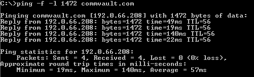

Example 1:
In the following example, using a Layer 2 MTU size of 1500, there are no discarded packets.
FAQ - How do I know whether my network supports the MTU I want to use? (1)

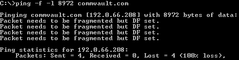

Example 2:
In the following example, using a Layer 2 MTU size of 9000, there are discarded packets.
FAQ - How do I know whether my network supports the MTU I want to use? (2)

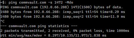

Example 1:
FAQ - How do I know whether my network supports the MTU I want to use? (3)

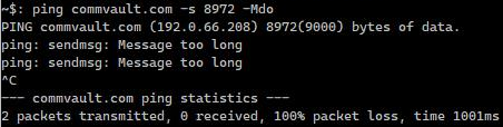

Example 2:
FAQ - How do I know whether my network supports the MTU I want to use? (4)
