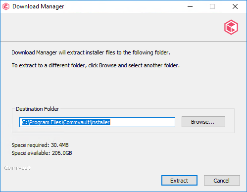

  2. Launch the Commvault software installation package.
    The Download Manager dialog box appears.
    embd_Installing the Standby CommServe Host procedure (9)
  3. Click Extract.

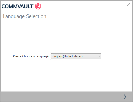

    The Language Selection page appears.
    embd_Installing the Standby CommServe Host procedure (10)
  4. Select the language from the Please Choose a Language list, and then click the arrow to proceed.

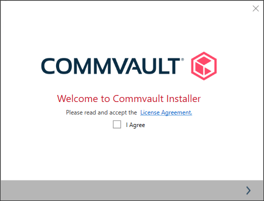

    The Welcome page appears.
    embd_Installing the Standby CommServe Host procedure (11)
  5. Select the I Agree check box, and then click the arrow to proceed.

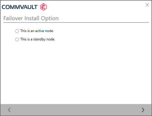

  10. The Failover Install Option page appears.
    embd_Installing the Standby CommServe Host procedure (14)
  11. Select This is a standby node, and then click the arrow to proceed.

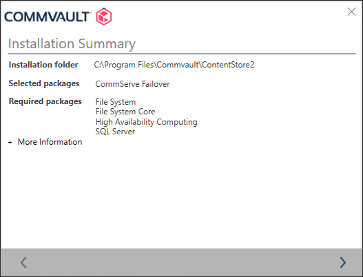

    The Installation Summary page appears.
    embd_Installing the Standby CommServe Host procedure (16)
  13. Verify the list of packages, and then click the arrow to proceed.

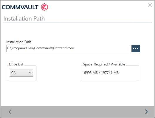

  18. Verify the path (or specify a new the path) for the standby CommServe server, and then click the arrow to proceed.
    Important
    Note that this Installation Path is for the CommServe server.

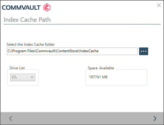

    The Index Cache Path page is displayed.
    embd_Installing the Standby CommServe Host procedure (23)
  19. Verify the index cache path (or specify a new path), and then click the arrow to proceed.

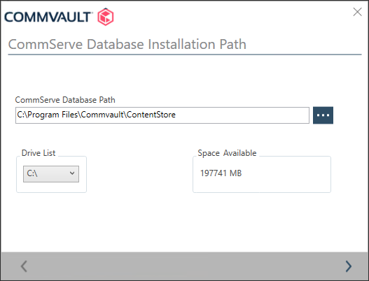

    The CommServe Database Installation Path page appears.
    embd_Installing the Standby CommServe Host procedure (24)
  21. Verify the CommServe database installation path (or specify a new path) and then click the arrow to proceed. (This is the path for storing the CommServe server databases.)

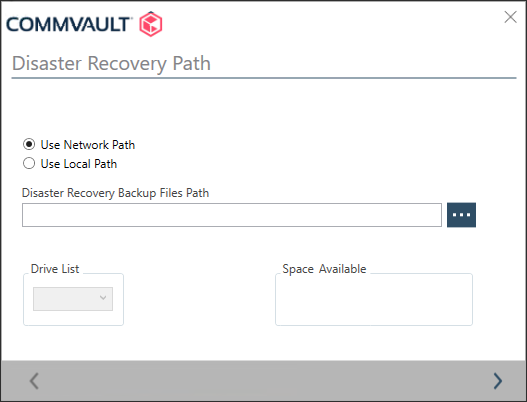

    The Disaster Recovery Path page appears.
    embd_Installing the Standby CommServe Host procedure (25)
  22. Select Use Network Path or Use Local Path, enter the path in Disaster Recovery Backup Files Path, and then click the arrow to proceed.

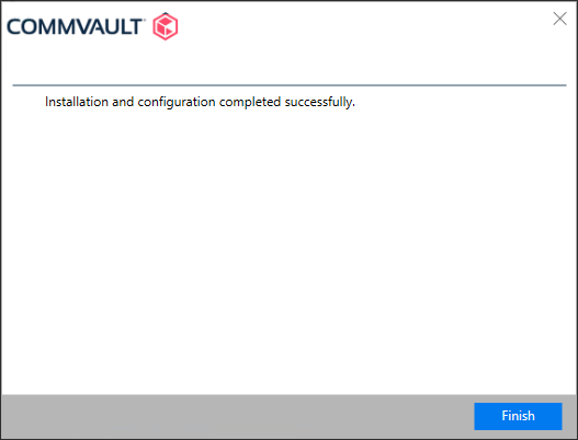

    The software creates the databases and services. This process may take a few minutes.
    A message similar to the following appears:
    embd_Installing the Standby CommServe Host procedure (27)
  24. Click Finish to complete the installation.
