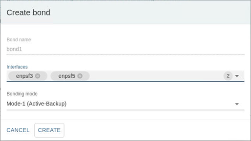

  3. Create a data protection interface bond as follows:
    1. Click Create bond.
      Tagged vLAN and Bonding (30)
    2. From the Interfaces list, select the data protection interfaces. (enpsf3 or enpsf5)
    3. From Bonding mode list, select either active-backup (Mode 1) or LACP (Mode 4).
    4. Click CREATE.
      Tagged vLAN and Bonding (17)

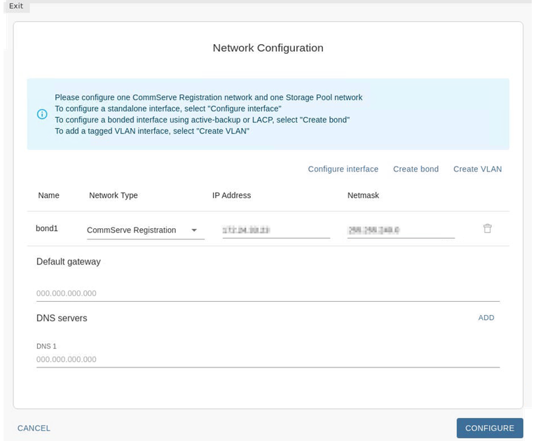

    5. From the Network Type list, select CommServe Registration
    6. Add the IP Address and Netmask in the respective boxes.
      LACP Bonding (1)

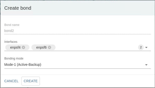

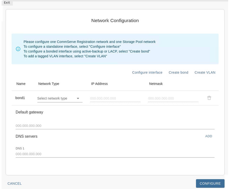

  4. Configure the storage pool interface (bonded) as follows:
      Tagged vLAN and Bonding (31)
    2. From the Interfaces list, select the 2 interfaces that will form the storage pool bond. (For example, enpsf4 and enpsf6 .)
    4. Click CREATE.
    5. From the Network Type list, select Storage Pool. This interface will be be used exclusively for communication and replication between the HyperScale nodes.
      LACP Bonding (2)

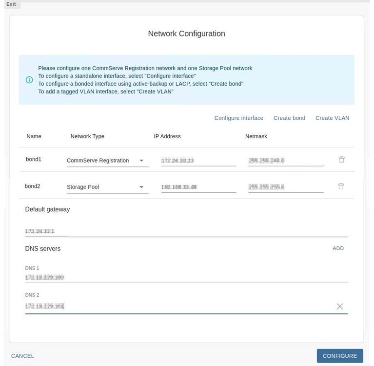

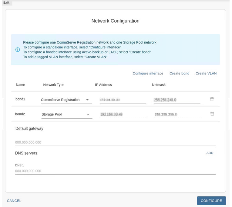

  5. Configure the DNS server(s) as follows:
      LACP Bonding (3)
    3. Click CONFIGURE.

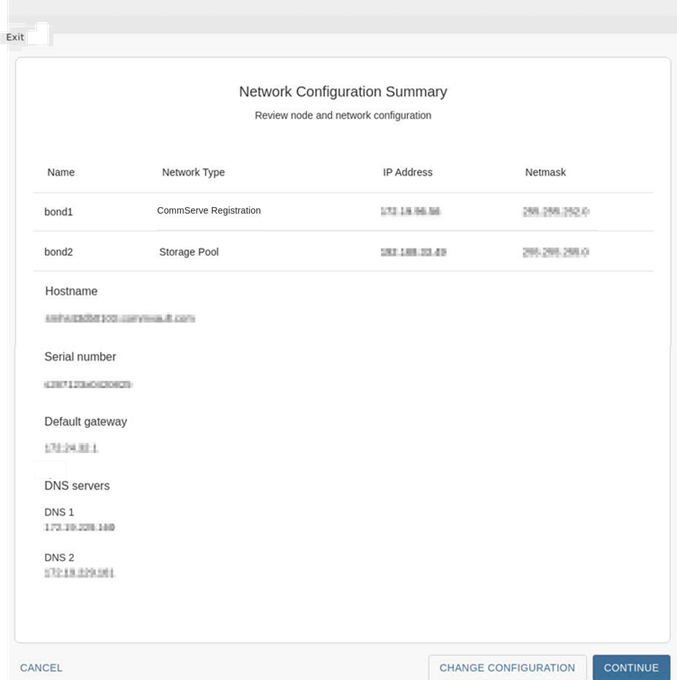

  6. Verify the network configuration and then click CONTINUE. Verify the following information.
    • IP address and netmask for the data protection interface is accurate.
    Tagged VLAN (7)
