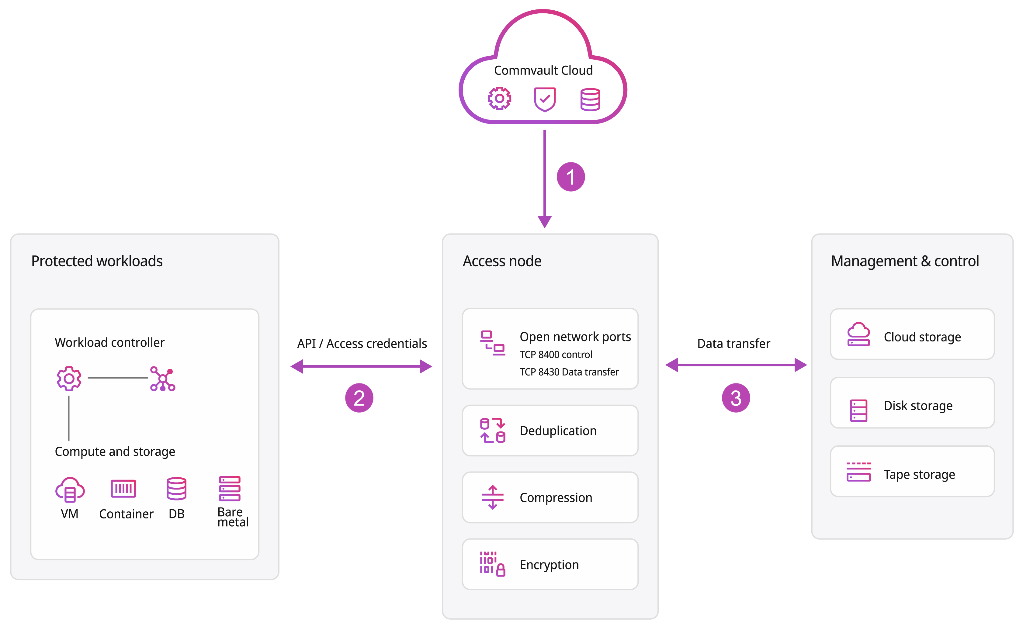

Backup traffic patterns
Backups typically use these paths:
  • An infrastructure component connects to the workload to read data (for example, an access node, MediaAgent, or client, depending on the workload).
  • Control traffic flows between the initiating component and the control plane.
  • Backup data flows from the data source to the configured storage destination.
In most Commvault SaaS environments:
  • The access node initiates connections to protected resources.
  • The access node communicates with Commvault services over HTTPS (TCP 443).
  • Backup data is transferred to cloud storage using the storage provider’s endpoints.
What varies by workload:
  • The ports and protocols required between the access node and the protected resource.
In most Commvault software environments:
  • The client and/or MediaAgent coordinates backup operations.
  • Backup data is written to storage using the configured data transfer ports.
What varies by environment:
  • Which component initiates the connection to the data source.
  • The data transfer port range you configure for your firewall model.
Restore traffic patterns
Restores often require different connectivity than backups because the initiating component and the direction of data transfer can change.
  • The access node retrieves backup data from storage.
  • The access node initiates a connection to the restore target.
  • Data is transferred back to the target resource.
  • The ports and protocols required between the access node and the restore target.
