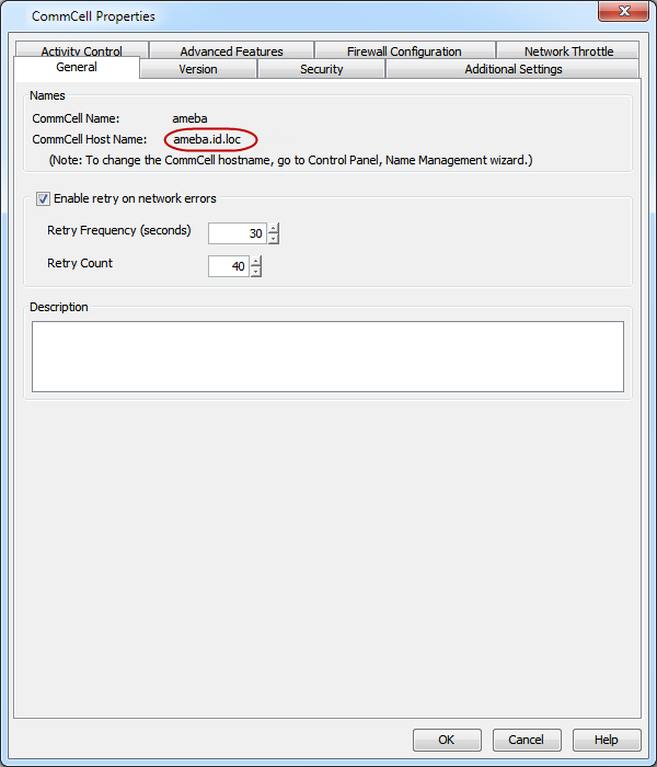

Check the configuration in the CommCell Console for the CommServe, MediaAgent and the Client with issues. Different phases of the backup or restore operations require reviewing different communications paths. Also, check the registry entries on the CommServe, MediaAgent and the Client.
The example below will cover the CommServe and the client computers.
From the CommCell Browser, right click the CommServe and click Properties. Check the CommCell Host Name.

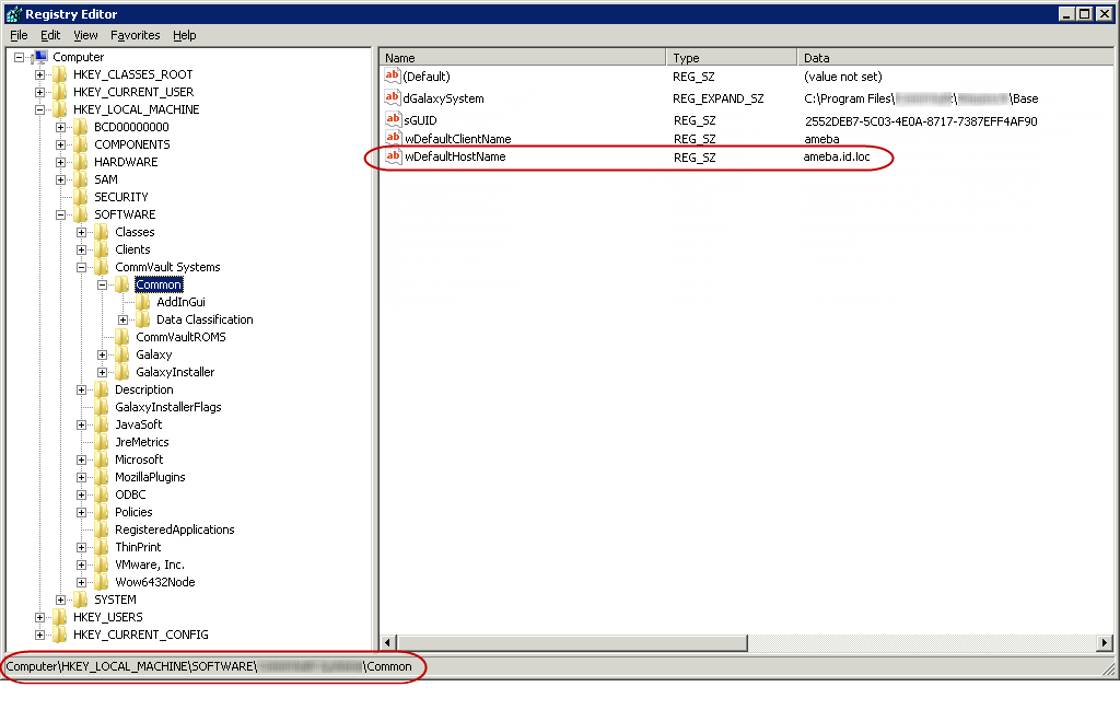

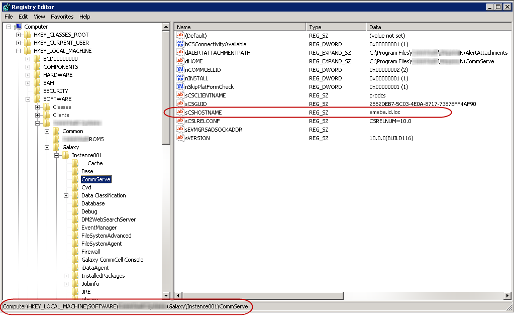

The registry on the CommServe (CS) will have two locations that show the CS Host Name when it also has a Client (CL) installed.
For the CommServe Name used by the Clients other then the CommServe Client the registry entry for sCSHOSTNAME is located under \HKLM\Software\Commvault Systems\Galaxy\Instance001\CommServe
For the CommServe with a Client (CL) File System Agent installed, the name is hosted at this registry location.
Registry entry for wDefaultHostName is located under \HKLM\Software\Commvault Systems\Common

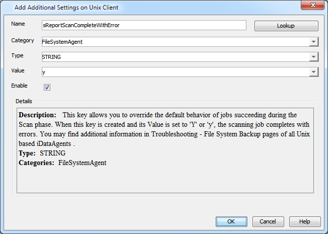

To view the "Completed w/ one or more errors" message in the Job History in the Scan phase, follow the steps given below:
From the CommCell Browser, navigate to Client Computers.
Right-click the <Client> and click Properties.
Click Advanced and then click Additional Settings tab.
Click Add.
In the Name field, type sReportScanCompleteWithError.
In the Value field, type y or Y to enable the error message display or n or N to disable the error message display..

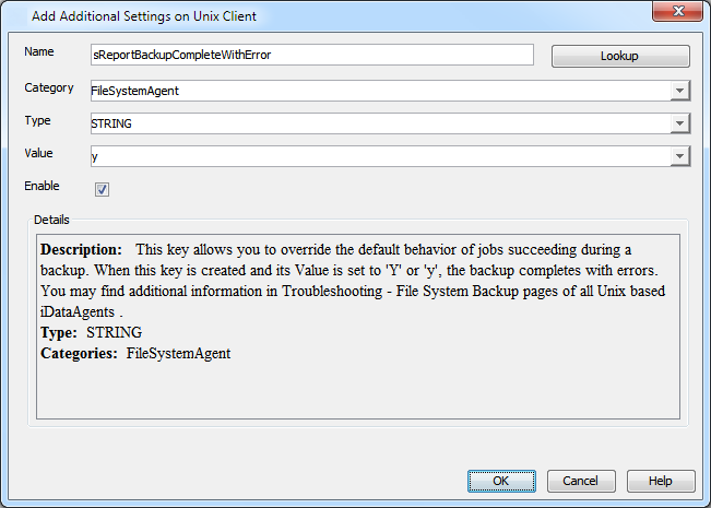

To view the "Completed w/ one or more errors" message in the Job History after a backup, follow the steps given below:
Click Add.
In the Name field, type sReportBackupCompleteWithError.

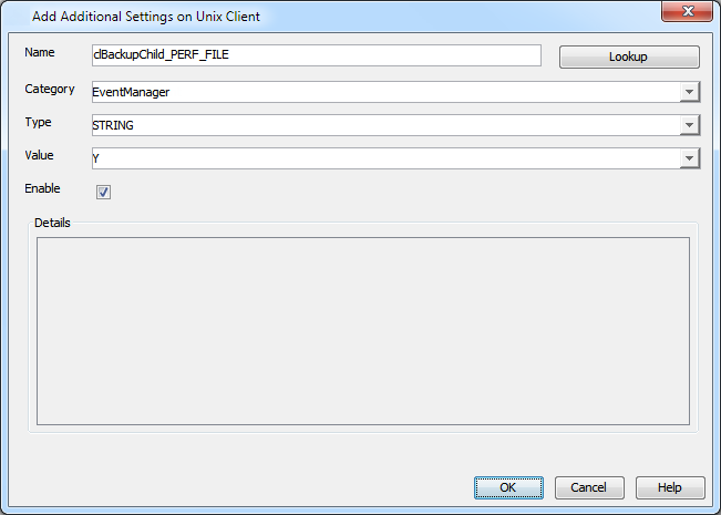

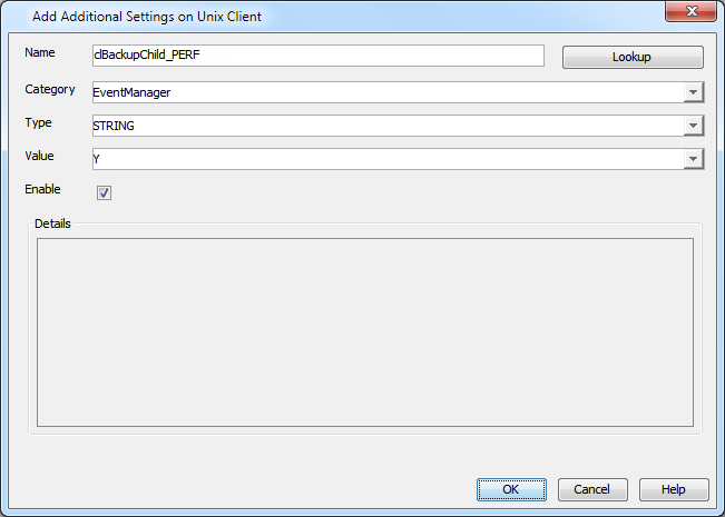

Troubleshooting Performance Issues
If you are experiencing performance issues during backup, you can troubleshoot them by enabling logging of performance details in the log files. These performance counters contain information that help in resolving the performance related issues during backups.
The performance counters printed in the log files include:
FileRead |
Average time spent in system call to read the file. |
CheckFileHole |
Average time spent to verify if buffer read from the disk is a hole. |
Close File |
Average time spent in system call to close the file. |
AllocBuffer |
Average time spent waiting for the network buffer. |
WriteBuffer |
Average time spent in sending the network buffer to the network. |
Disk Read |
Average speed of reading from the disk. |
Write |
Average speed of writing to the network. |
Displaying Performance Details of a Backup Job
Click Add.
In the Name field, type clBackupChild_PERF.
In the Value field, type Y.
Displaying Performance Details for Each File in a Backup Job
In addition to viewing the performance details for a backup job, you can also view the performance details of each file in the backup job. Note that the file names are not printed in the log.
Click Add.
In the Name field, type clBackupChild_PERF_FILE.
This additional setting should be used together with the clBackupChild_PERF additional setting.

8000 1f64 07/25 13:14:33 ### Unable to resolve remote host_Disabled_CSFQDNServerName to any IP family: [1][11001][No such host is known.] 8000 1f64 07/25 13:14:33 ### ** CVSsession::attach(ulPortArg): - RemoteHost=_Disabled_CSFQDNServerName. - RemoteProcess=. Port =65535,65535 - getConnection() failed. Error=900004b. 8000 1f64 07/25 13:14:33 ### ** CVSession::getClientPassword (): - RemoteHost=_Disabled_CSFQDNServerName. - RemoteProcess=JobMgr.exe. - commServerAttach (ePlatformTypeMember) failed. Error=900004b. 8000 1f64 07/25 13:14:33 ### ** CVSession::replyAttach (PlatformType) - RemoteHost=CSFQDNServerName. - RemoteProcess=JobMgr.exe. - authenticateServer failed. Error=9000024.Resolution:
If the nChatterFlag additional setting is set to 1, normal Communication and Connection testing will work properly but communication between MediaAgent or Client and the CommServe will continue to fail.
NOTE: The core issue is the MediaAgent or Client realized it was getting nowhere trying to talk (authenticate) to the CS and stops talking by setting the nChatterFlag and other additional settings. The cause of this type of behavior is outlined above but may also be caused by transient or extended CVD communication issues between elements of the CommCell and the CommServe.
To fix the issue, check the additional settings on the CommCell Components affected.
On Windows:
Check the nChatterFlag additional setting.
Right-click the <Client> or <MediaAgent>, and then click Properties.
Click Add.
In the Name box, type nChatterFlag.
In the Value box, type 0.
This enables communication to the CommServe.
Check the sCSHOSTNAME additional setting.
Click Add.
In the Name box, type sCSHOSTNAME.
In the Value box, if the current string value has _Disabled_ appended at the front of the string value, remove it to allow communication to the CommServe.
Click Add.
Click Add.
If there is a firewall between the MediaAgent or Client and the CommServe, check the nDISABLE_CVFWD additional setting.
Click Add.
In the Name box, type nDISABLE_CVFWD.
This enables controlled connection to the CommServe.
Restart Commvault services.
Test Backups and Restores to confirm data protection has been restored.
