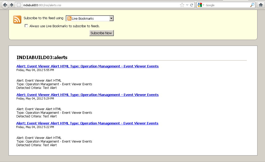

You can send alerts in the form of RSS feeds which can be automatically integrated with your web browser. The following is an example of an RSS Feeds notification alert:
On the Notification Type(s) Selection page, click the RSS Feeds tab to send the alert to an RSS feed.
Click the Select [RSS Feeds] for notification check box.
If you need to provide a different RSS feed location (other than the default alerts,rss), select the location from the Select/Enter the Feed Location drop-down list.
Click Next.
Review your selections on the Summary page.
Click Finish.
