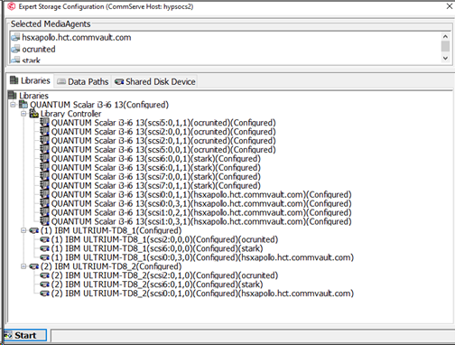

    The Expert Storage Configuration dialog box should display one library instance with multiple library controller paths, and primary and alternate paths of each drive within this instance.
    Tape Library with Multipathing Failover (2)

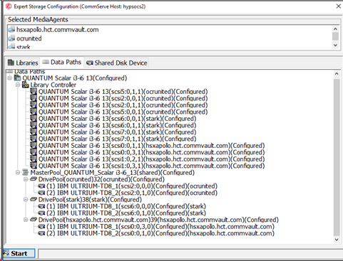

    From the Data Paths tab, you would see two DrivePools for each MediaAgent.
    Tape Library with Multipathing Failover (1)
    The above image displays an HyperScale X 2.3 Linux MediaAgent and two Linux <MEDIAAGENTS> with a multipathing partition of one physical medium changer and two dual port tape drives.
    Note that while using the example of a multipathing partition with one physical medium changer and two tape drives with dual fabric ports, the OS will see four medium changers (Control Path enabled on both drives) and four tape drives. Commvault ScanScsiTool output will display four library instances (one for each medium changer path) and four tape drive instances (two for each drive). This is the direct result of both FC ports on each drive having an active-active behavior in conjunction with proper zoning. Each library instance and drive instance will have the same serial number. As shown in the example, there will be two tape drive instances with identical serial numbers for each physical drive.
