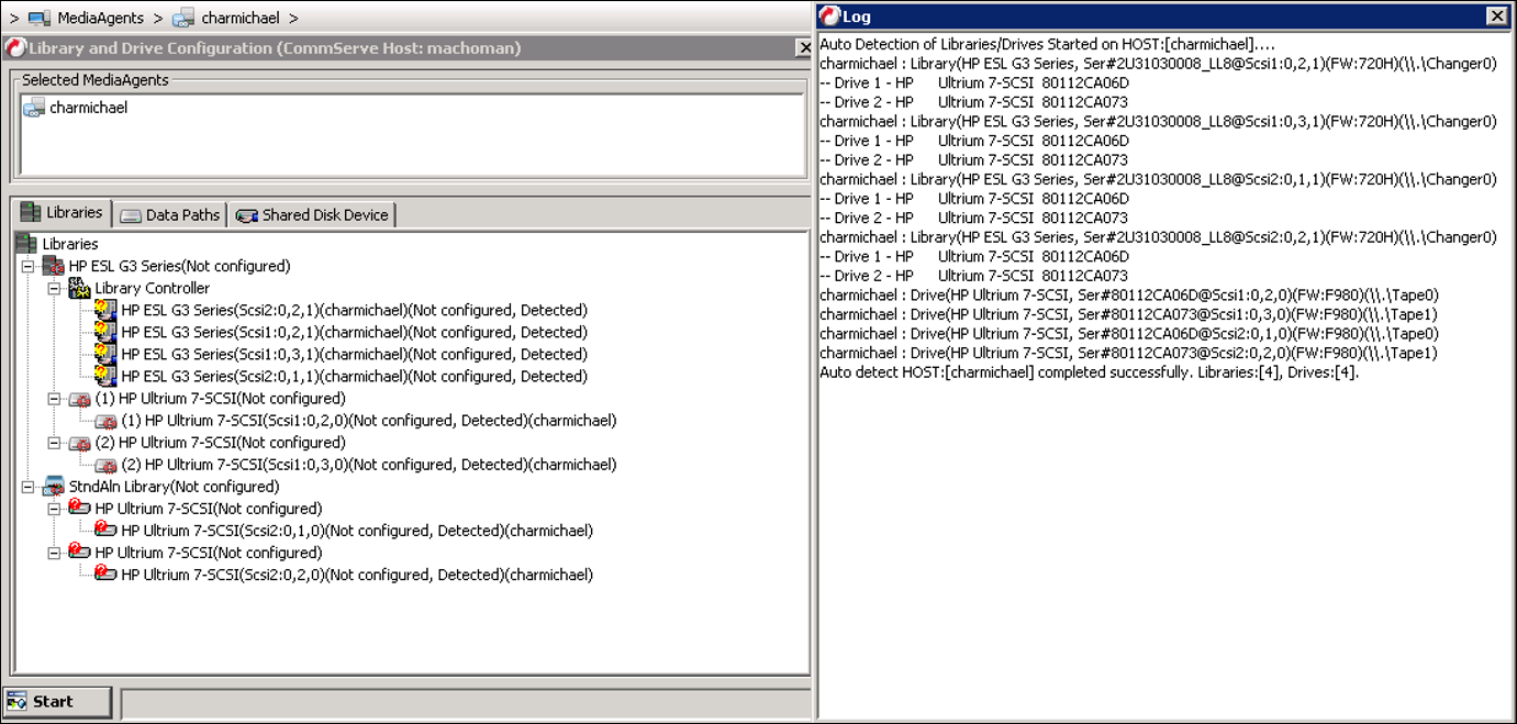

    The Expert Storage Configuration dialog box should display one library instance with multiple library controller paths and primary paths of each drive within this instance. If multiple MediaAgents are in the detect and configure, then you would see all the library controllers for the library for each MediaAgent within the library instance and all primary paths for each drive for each MediaAgent. All alternate paths for the drives (single MediaAgent or multiple MediaAgents) should show up as stand-alone drives.
    apfo_example
    The above image displays a Windows MediaAgent and an Advanced Path Failover (APFO) partition of one physical medium changer and two dual port tape drives.
    Note that while using the example of an APFO partition with one physical medium changer and two tape drives with dual fabric ports, the OS will see four medium changers and four tape drives. Commvault ScanScsiTool output will display four library instances (one for each medium changer path) and four tape drive instances (two for each drive). This is the direct result of both FC ports on each drive having an active-active behavior in conjunction with proper zoning. Each library instance and drive instance will have the same serial number. As shown in the example, there will be two tape drive instances with identical serial numbers for each drive.
