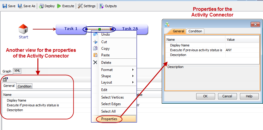

You can update the properties of an activity connector in the workflow design area. Unless some conditions need to be specified, you are not required to configure its properties as most connectors play the role of indicating the next activity to be executed.
The properties for an activity connector can be accessed as follows:
  • By selecting the connector. The activity connector properties are displayed below the workflow design area.
  • By right-clicking the connector and then clicking Properties. The activity connector properties are displayed in a dialog box.
connector_properties
