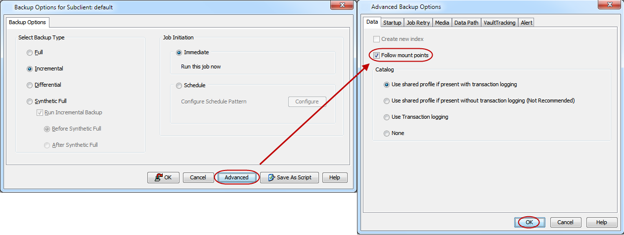

Back Up Mount Points
Backups follow mount points by default, backing up both the configuration and the data on the mounted volume. You can use another subclient to backup the data on the mounted volume. In such case, you can exclude the data on the mounted volume from the default backup.
  1. From the CommCell Browser, navigate to <Client> | File System | defaultBackupSet.
  2. Right click the default <Subclient> and click Backup.
  3. Select Full as backup type and Immediate to run the job immediately.
  4. Click Advanced and select the Advanced Backup Options dialog box.
  5. In the Advanced Backup Options dialog box, click the Data tab.
  6. Select (or clear) Follow Mount Points to include (or exclude) mount point data from the subclient.
  7. Click OK.
    Depending upon your selection, the mount point data will be included or excluded from the default subclient backup.
bkp_mnt_pnts
