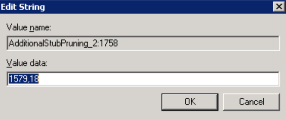

Example of Pruning Migrated Stubs
Stubs archived by SubclientID 1579 and SubclientID 18 are moved to SubclientID 1758. Create the AdditionalStubPruning_<CommCellId>:<CurrentSCId> additional setting and set the value as follows:
where:
AdditionalStubPruning_2:1758 = name of the additional setting
2 = CommCell ID of the CommCell Console
1758 = subclient ID of the subclient that contains data of subclient 1579 and subclient 18 that must be pruned
1579 and 18 = the IDs of subclients whose data is moved to subclient 1758
