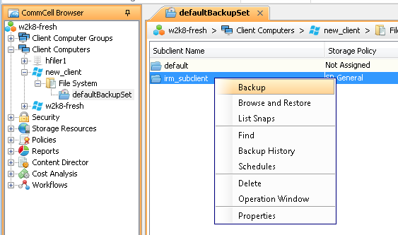

  1. From the CommCell Browser, navigate to Client Computers | <Client> | MySQL | <Instance>.
    Right-click the default subclient and click Backup.
    backup_01

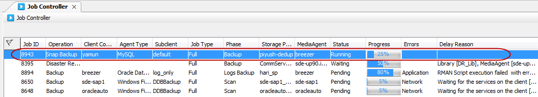

  2. In the Backup Options for Subclient dialog box, click Full as the backup type and then select Immediate.
  3. You can track the progress of the job from the Job Controller window of the CommCell console.
    backup_03

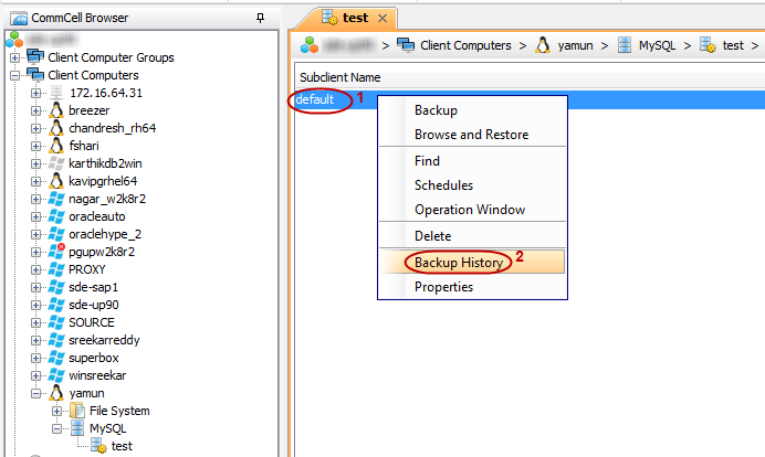

  4. Once the job is complete, view the job details from the Backup History. Right-click the Subclient and select Backup History.
    backup_04

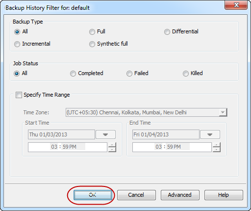

  5. Click OK.
    backup_05

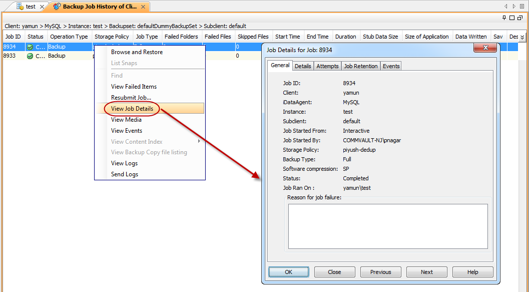

  6. Right-click the job to:
    • Browse the database that was backed up.
    • View Failed Items.
    • Resubmit the job.
    • View job details.
    • View media associated with the job.
    • View events associated with the job.
    • View or send the log file that is associated with the job.
    backup_06
